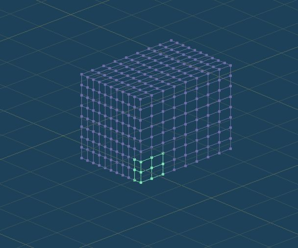

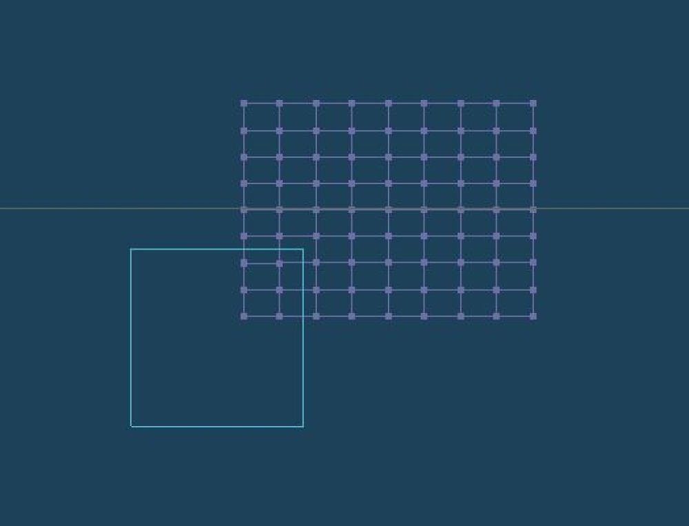

[10576] Normal changed during object merging / JimmyMarco3D
[不具合報告] 返信
Hi,
Another bug with the non fixed normal vectors.
When we merge two objects with the Normal command panel opened, non fixed vectors orientations are changed :
https://i.goopics.net/ckyk2l.jpg
https://i.goopics.net/g2b43k.jpg
Problem doesn't occure when another command is active, so cancel the merging and remerge objects with a selection tool activated for example, and I hope this little can be corrected.
Bests regards.
JymmuMarco3D

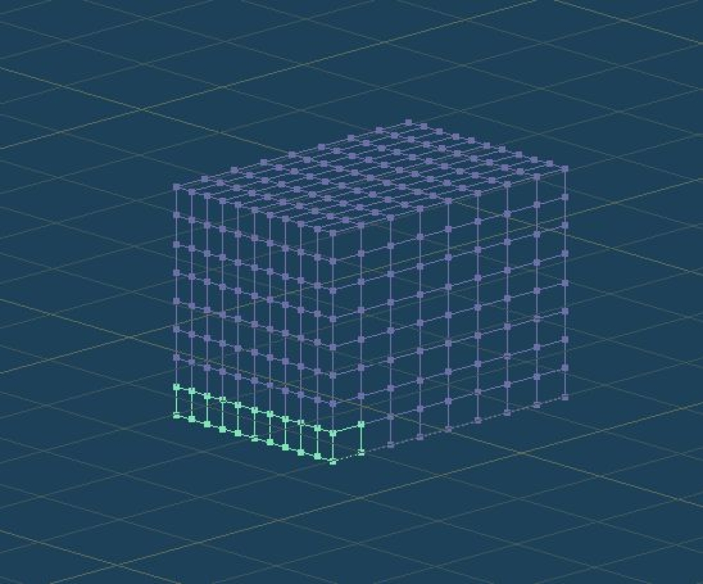

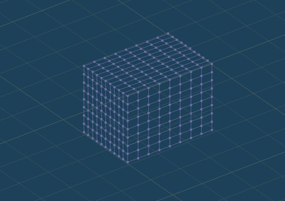

[10553] Fixed Normal vectors scaling problem and French Patch update / JimmyMarco3D
[不具合報告] 返信
Hi,
In my previous message, I haven't explained clearly the Fixed normal vectors scaling problem, so this screenshots show what happened when the Scale option is used in Local axis command :
https://i.goopics.net/0r6hgx.jpg
https://i.goopics.net/h2d8z8.jpg
https://i.goopics.net/640oin.jpg
The fixed vectors are x10 bigger when the Scale is setted x10.
Last update of the French patch.
https://www.aht.li/3959385/PatchFrancaisMetasequoia490f.zip
Bests regards.
JimmyMarco3D
