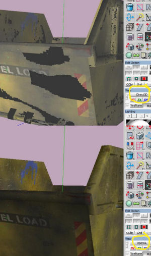

[2988] Re: Re: release notes / airflamesred
Maybe I need to upgrade direct X? Please see attatched
File [mqbbs1.jpg]
2013-02-05 06:48
[2989] Re: Re: Re: release notes / Administrator
Maybe DirectX9 is installed.
When you choose Direct3D in the button, bump and normal maps will be displayed.
However, they cannot be displayed if you use an old PC that does not support Pixel Shader 2.0.
2013-02-05 13:58
[2990] Re: Re: Re: release notes / Administrator
And [Menu > View > Show precisely] must be checked to display bump/normal maps.
2013-02-05 14:00
[2995] Re: Re: Re: Re: release notes / airflamesred
After some investigation I have direct X 10.1 and shader 4.1. I have checked all your suggestions.
2013-02-07 02:43
