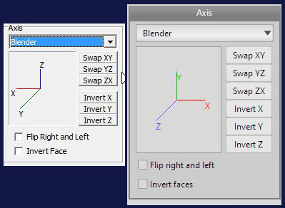

Bug maybe in Metasequoia 4.3.4.
The axes diagram in the export Dialog when you select Blender has changed from Metasequoia 3.
See attached images.

This is not a bug.
The recent Blender imports with the axes conversion in .obj, .fbx and so on. Now, the axes are not necessary to be converted at the time of exporting.
So, the axes are same as the default in the Metasequoia 4. This reserves the same appearance in both Metasequoia and Blender.
