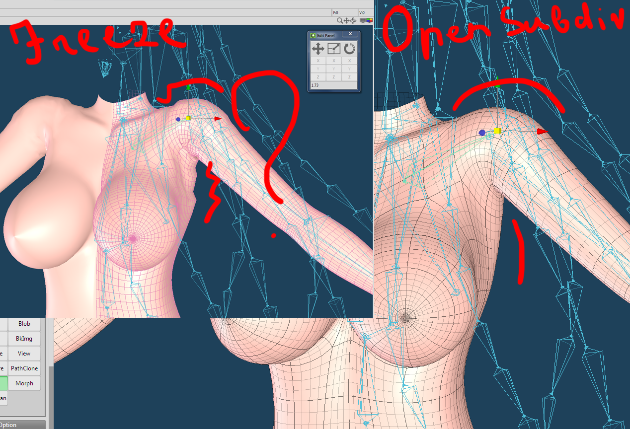

When I model, I use OpenSubdiv. After rigging, because of the way metasequoia pmd plugin works I freeze the subdivision to export the character to .pmd, but because of that the rigging breaks. How do I fix it?
File [11.PNG]

It is impossible to use both subdivision and rigging for .pmd. It is necessary to freeze the subdivision before rigging. Unfortunately, there is currently no way to fix it.
